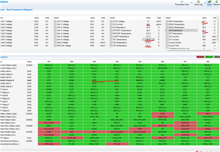

BQ76952: OTC and OTD Protections don't work correctly
Part Number: BQ76952
hello
I use BQ76952 as BMS and have 4 NTCs for cell temp and 2 NTCs for mosfet
here are the configs of these 6 pins
    Error_flag=BQ769x2_SetRegister(TS1Config, 0x07, 1);
    if(Error_flag)
        return Error_flag;
    Error_flag=BQ769x2_SetRegister(TS2Config, 0, 1);
    if(Error_flag)
        return Error_flag;
    // Set TS3 to measure Cell Temperature -0x92FF = 0x07
    Error_flag=BQ769x2_SetRegister(TS3Config, 0x07, 1);
    if(Error_flag)
        return Error_flag;
    // Set HDQ to measure Cell Temperature - 0x9300 = 0x07
    Error_flag=BQ769x2_SetRegister(HDQPinConfig, 0x07, 1);
    if(Error_flag)
        return Error_flag;
    // Set CFETOFF to measure Cell Temperature - 0x92FA = 0x07
    Error_flag=BQ769x2_SetRegister(CFETOFFPinConfig, 0x07, 1);
    if(Error_flag)
        return Error_flag;
    // Set DDSG to measure MOSFET Temperature - 0x9302 = 0x0F
    Error_flag=BQ769x2_SetRegister(DDSGPinConfig, 0x0F, 1);
    if(Error_flag)
        return Error_flag;
    // Set DDSG to measure MOSFET Temperature - 0x9301 = 0x0F
    Error_flag=BQ769x2_SetRegister(DCHGPinConfig, 0x0F, 1);
    if(Error_flag)
        return Error_flag;
and here is Enable Protection B and Alarm mask
    Error_flag=BQ769x2_SetRegister(EnabledProtectionsB, 0xF7, 1);
    if(Error_flag)
        return Error_flag;
     Error_flag=BQ769x2_SetRegister(DefaultAlarmMask, 0xF882, 2);
    if(Error_flag)
        return Error_flag;
and here is OTC and OTD config and for mosfet default values are ok
	Error_flag=BQ769x2_SetRegister(OTCThreshold, 45, 1);//charge over temp  10-45 according datasheet
		    if(Error_flag)
        return Error_flag;
	Error_flag=BQ769x2_SetRegister(OTCDelay, 2, 1);
				    if(Error_flag)
        return Error_flag;
	Error_flag=BQ769x2_SetRegister(OTCRecovery, 40, 1);
    if(Error_flag)
        return Error_flag;
		Error_flag=BQ769x2_SetRegister(OTDThreshold, 55, 1);//discharge over temp  -20-55 according datasheet
		    if(Error_flag)
        return Error_flag;
	Error_flag=BQ769x2_SetRegister(OTDDelay, 2, 1);
				    if(Error_flag)
        return Error_flag;
	Error_flag=BQ769x2_SetRegister(OTDRecovery, 50, 1);
    if(Error_flag)
        return Error_flag;
the problem is none of the temperature protections for Cells or Mosfets will trigger or make mosfet off

    if(Error_flag)
        return Error_flag;
		 Error_flag=BQ769x2_SetRegister(OCCRecoveryThreshold, 300, 2);
    if(Error_flag)
        return Error_flag;
    // Set up OCD1 Threshold - 0x9282 = 0x0A (20 mV = 20A across 1mOhm sense resistor) units of 2mV
    Error_flag=BQ769x2_SetRegister(OCD1Threshold, (PACK_MAX_DISCHARGE_CURRENT/2), 1);
    if(Error_flag)
        return Error_flag;
	    // Set up OCD1 delay 100 *3.3ms = 3.3s
	    Error_flag=BQ769x2_SetRegister(OCD1Delay,120, 1);
    if(Error_flag)
        return Error_flag;
	    // Set up OCD2 Threshold - 0x9282 = 0x0A (20 mV = 20A across 1mOhm sense resistor) units of 2mV
    Error_flag=BQ769x2_SetRegister(OCD2Threshold, ((PACK_MAX_DISCHARGE_CURRENT+80)/2), 1);
    if(Error_flag)
        return Error_flag;
		 Error_flag=BQ769x2_SetRegister(OCD2Delay,20, 1);
    if(Error_flag)
        return Error_flag;
		//set threshold to turn off ocd alert , ma
		Error_flag=BQ769x2_SetRegister(OCDRecoveryThreshold, 10, 2);
    if(Error_flag)
        return Error_flag;
			//set threshold to turn off ocdl alert , ma
		Error_flag=BQ769x2_SetRegister(OCDLRecoveryThreshold, 10, 2);
    if(Error_flag)
        return Error_flag;
    // Set up SCD Threshold - 0x9286 = 11 (300 mV = 200A across 1mOhm sense resistor)  0x05=100mV
    Error_flag=BQ769x2_SetRegister(SCDThreshold, 11 , 1);
    if(Error_flag)
        return Error_flag;
    // Set up SCD Delay - 0x9287 = 0x0B (150 us) Enabled with a delay of (value - 1) * 15 µs; min value of 1
    Error_flag=BQ769x2_SetRegister(SCDDelay, 0x0B, 1);
    if(Error_flag)
        return Error_flag;
    // Set up SCDL Latch Limit to 1 to set SCD recovery only with load removal 0x9295 = 0x01
    // If this is not set, then SCD will recover based on time (SCD Recovery Time parameter).
    Error_flag=BQ769x2_SetRegister(SCDLLatchLimit, 0x01, 1);
    if(Error_flag)
        return Error_flag;
    // Exit CONFIGUPDATE mode  - Subcommand 0x0092
    Error_flag=Subcommands(MANU_DATA, 0xaaaa, W32);
    if(Error_flag)
        return Error_flag;
    Error_flag=BQ769x2_SetRegister(MfgStatusInit, 0x0080, 2);
    if(Error_flag)
        return Error_flag;
//		#define CoulombCounterOffsetSamples 0x91C6      //Calibration:Current Offset:Coulomb Counter Offset Samples
//#define BoardOffset 0x91C8
    Error_flag=CommandSubcommands(EXIT_CFGUPDATE);
    if(Error_flag)
        return Error_flag;
    return OK;
thanks
Alireza
