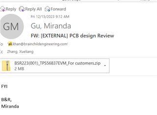

I need PCB design review based on TPS56837.
I also need EVM pcb files if possible.

Hi Khan
The Miranda is OOO, please send the PCB files to my email(xueliang.zhang@ti.com), I will review it and give you a feedback, thanks!

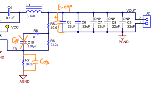

I have a question. I saw many markets BEC that used big Capacitors for same functions.
Is it necessary in my case if i have to run motors?
Hello Ali,
I have sent you PCB file on 12/15, have you received it?

Could you share more application details? I don't know where is 'big capacitor' that you said. If you mean add a big Electrolytic Cap (E-cap) at TPS56837 output, please take care of it. Because the E-cap has high ESR and will introduce a low-frequency ESR-zero into loop, which may cause loop instability. If you have to use the high-ESR E-cap, please remove the Cff and add a small Cfb from FB-pin to GND (Cfb value cannot be large, try 100pF), like below.
And seems the product you shared supports adjustable Vout. But our device is a simple buck without any I2C/PMBus/... interface, if you need Vout adjustment, you may add more circuits to implement (e.g add a MOS switch to change FB resistor).
Hi Miranda Gu
Yes i received PCB files.
I don't need adjustable because i required two outputs and i did it using jumper and resistor.
I have to run some servo motors and i found most of the buck converter available in the market used big E-CAP. I was curious if i need as well because i followed WEBENCH design to create the board.
Hi Ali,
Webench design follows our datasheet recommended LC table (Table 8-2), which is based on MLCC Cout, not E-cap Cout.
If you need to use E-cap Cout, as I suggested in previous reply, please remove Cff and add a small Cfb to ensure loop stability. You can send me your schematic for review (you know my email address).
