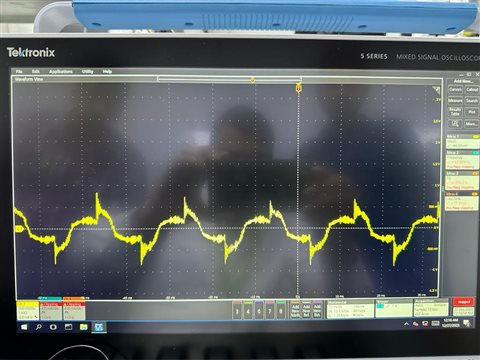

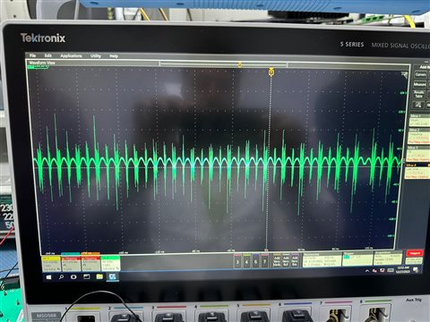

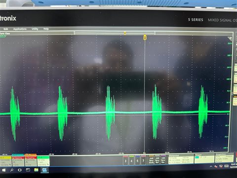

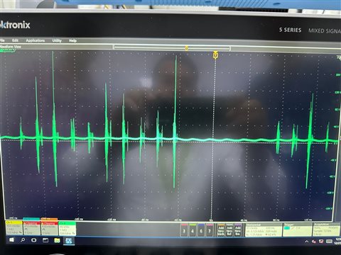

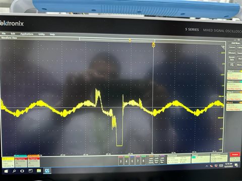

  • Hi Ulrich,
    We have received waveforms from customer.
      (VCOMP waveform with PF correction)
      (VCOMP waveform when PF correction stopped)
      (ICOMP waveform at PF correction)
      (ICOMP waveform when PF correction stopped)
      (Input current 100W PF=0.3W)
      (input current 70W PF=0.7)
  • Hello Kartik,
    I have to admit, these are extremely strange waveforms.  Unfortunately none of them have enough information to allow me to come to any conclusion.
    VCOMP with PFC has huge amounts of noise every 20ms.  Noise pickup from a long GND lead on the oscilloscope probe may account for that, but I would have expected it to recur at 10ms intervals, not at 20ms.
    VCOMP without PFC has quiet intervals lasting almost 120ms.  What is the PFC stage doing during this interval?

    ICOMP with PFC appears to be almost normal at first, except with a lot of noise (this time at 10ms zero-crossings).  But closer look shows that the amplitude is about 23V! (half a division at 46V/div.)  This is not possible, since the controller would be irreparably damaged at 23V.
    ICOMP without PFC is even worse at > 46Vpk, and apparently in half-wave operation.
    I can't believe that these are ICOMP signals, unless they are amplified somehow or the display scale is wrong.
    The input current waveforms have a scale of 500mV/div.  Can you please convert them to A/div, so I can assess their magnitudes with respect to the expected load and input voltage?  I have a suspicion that the sinusoidal parts of the currents are due to the EMI filter X-caps, not load current.  Except for the distortions, which do contain current that makes it through to the load.
    All of these waveforms are presented individually, without context of relationship to other signals in the converter.  There is no reference to the zero-crossings of the rectified input; no GATE signal information; no Vout waveform; no MOSFET waveform, and no indication as to what causes the extreme noise bursts every 20ms.  The oscilloscope is capable of accepting 8 channels, so I think it would be very useful to display several signals at the same time to see what might be happening in different parts of the circuit during the strange operation.  I suggest to use normal scaling (like 5V/div, 10V/div, 1A/div, etc.) instead of unusual scales like 46V/div and others like that.
    I don't see anything in the schematic diagram that could account for the waveforms shown so far.  Therefore the problem(s) must be on the prototype board being tested.  Look for solder-shorts, open circuits, or backwards components.   Perhaps debug might be improved if a DC input were provided to the PFC.  It should be have exactly as a DC boost converter.
    Test at low power levels, and vary the DC slowly to see what effect changing voltage has on the output and on the various waveforms.
    Ulrich
