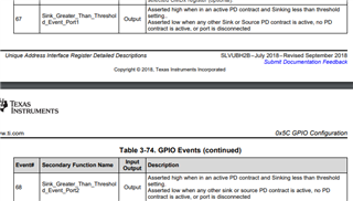

    TPS65987 GPIOs are limited to the events advertised in the TRM.

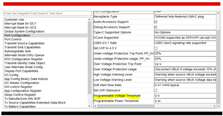

    We have an event that will trigger if you are sinking a voltage greater than a defined threshold that may work in your case. You can set the voltage threshold in the Port Configuration register.
