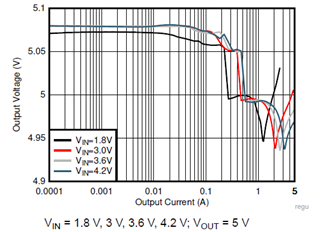

    The 8A is inductor current limit, not output current, the output current can't be as high as 8A.
    And more, It is a stable value, when there is a load transient, there will be undershoot and overshoot at output voltage. So that is why I want to check based on the waveform, if the 5V drops to 4.6V only for a short time or for a long time. Because TPS61022 can support 4V to 5V/2A condition theoretically. You can see this from our datasheet.

  • Indeed your data-sheet says that but it's on the assumption the feed forward is adjusted for the input voltage level in question. Since this is fixed in real-life it means the voltage under or over-shoots at some point depending on the input voltage/output current combination. Anyone using the chip with super-capacitors like I am is going to find the chip is 'over-sold'.
    I have a buck driving an LED on the output of the 61022 so it won't be a nice resistive load. I'm in production with it on two products so I did the best I could with it, which is a 120p capacitor and a hard restriction on the output current when the input voltage is low. The max current at higher input voltage level is around the 2A, due to voltage drop as stated above.
    Given the capacitance is so low perhaps TI should think about 'switching in' feed forward capacitance depending on the input voltage level, which would give a wider mode of operating range with expected regulation performance.
    I have since found I can remove the 220uF polymer, so my combination now is 5x 22uF 0805 10V ceramics and 120p feed forward. If I didn't use a fast 5MHz UVLO on the output and a max current restriction at low input voltage level the 61022 would burn.

  • Hi Andrew,
    The maximum output current  is actually related to the input voltage, because we limit the input current, the lower input voltage, the lower maximum output current.
