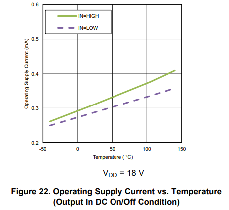

UCC27531: What is the actual quiescent current for this part?
Part Number: UCC27531
I am designing the circuit where the idle current must be kept to absolute minimum. The datasheet for UCC27531DBVR does not have quiescent current, other than vague "The UCC2753x features very low quiescent currents (less than 1 mA)". Can you provide a bit more specific number?
