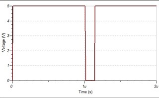

    By negative pulse, I mean output referred. That is, an input that creates a high output with a short low pulse, such as a 90% duty cycle PWM on IN+, and IN- held low.
    By narrow positive pulse, I mean an input that creates an output with a short high pulse, such as a square wave with a 10% duty cycle:
    By definition, negative vs. positive pulse depends on the initial output state. But the minimum pulse time of either polarity should be the same. They both equate to the same bandwidth.
