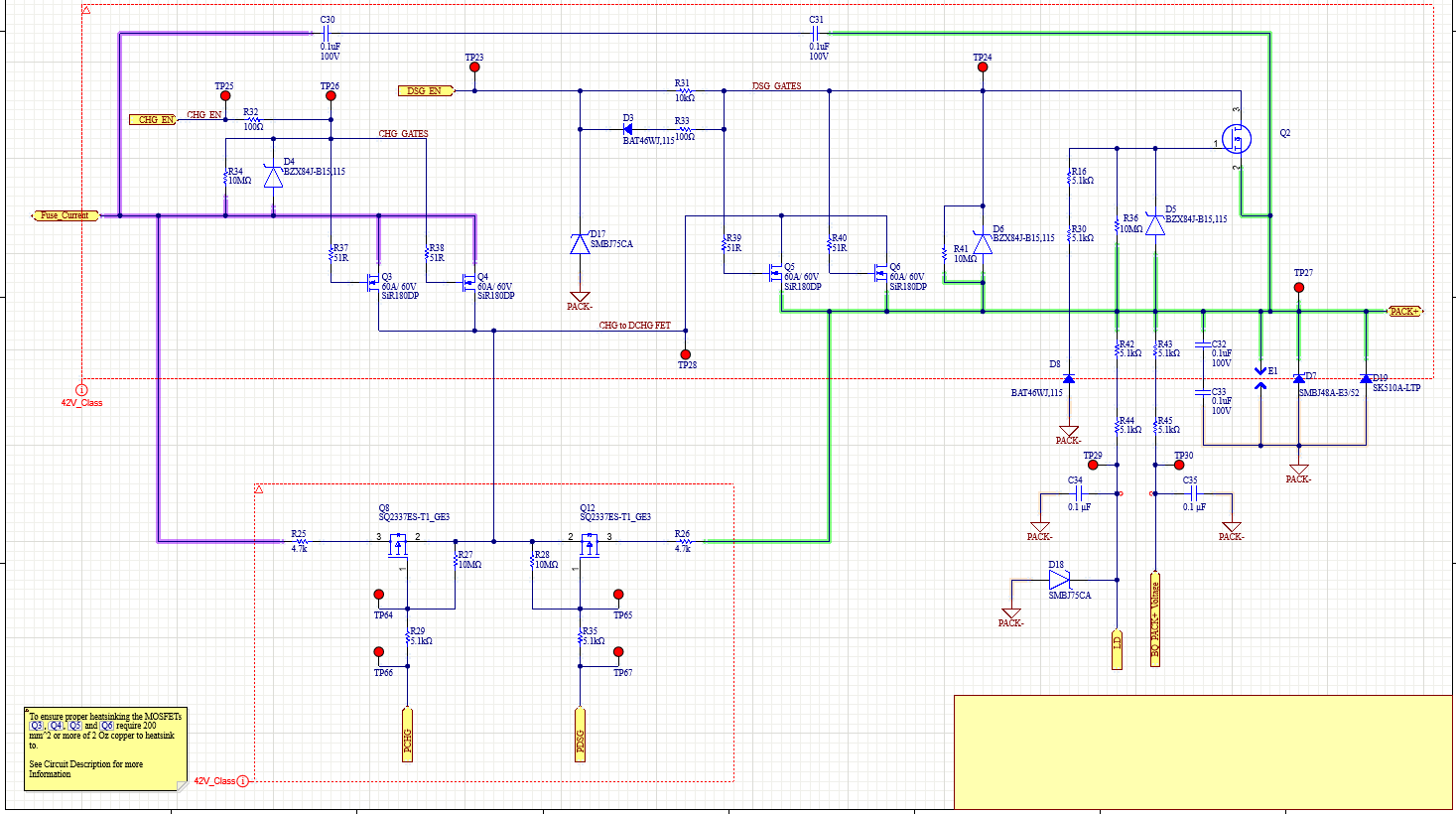

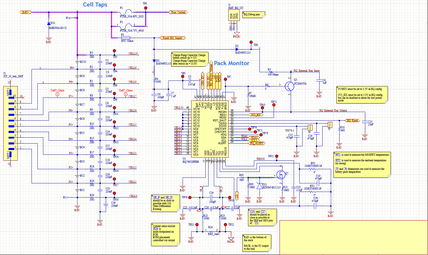

We are having an issue where the SCD protection appears to be causing the DSG FETs to fail short. Schematics attached for reference.
The circuitry attached to TS2 is not fitted, please ignore.

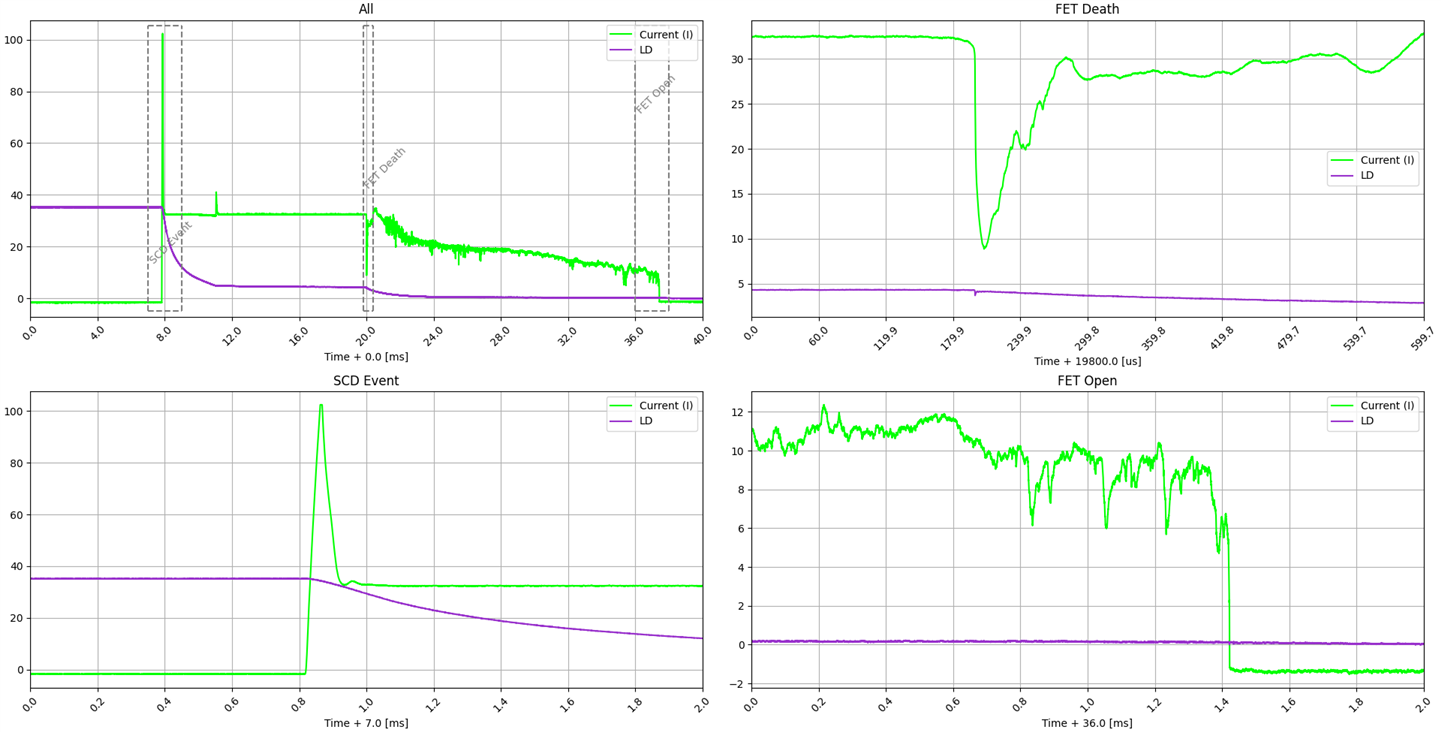

The plots attached below show a lot of what we believe is going on:
If we look at the top left plot first:
  • There the black spike shows the discharge current under short circuit conditions
  • The Gate drive voltage (RED) is nice and clear of the source voltage (BLUE) value and appears to begin clamping towards 0V to turn off the FETs. Part way through this clamp, something happens where this process stops, the values seem to get stuck and we assume at this point the FETs are blowing.
These details can be seen in more detail in our zoomed in plots titled as marked on the Full plot.
In 'SCD event' plot we can see that the gate voltage drops sharply as the protection kicks in but fails to clamp completely.
This is a 10S1P Battery pack using Molicel P42A (Cell Stack typical DC impedance ~160mOhm) and SIR180DP MOSFETs with the BQ79652.
25V Min 42V Max 36V Nom
Any help to solve this problem is appreciated, I can also collect any more data required.

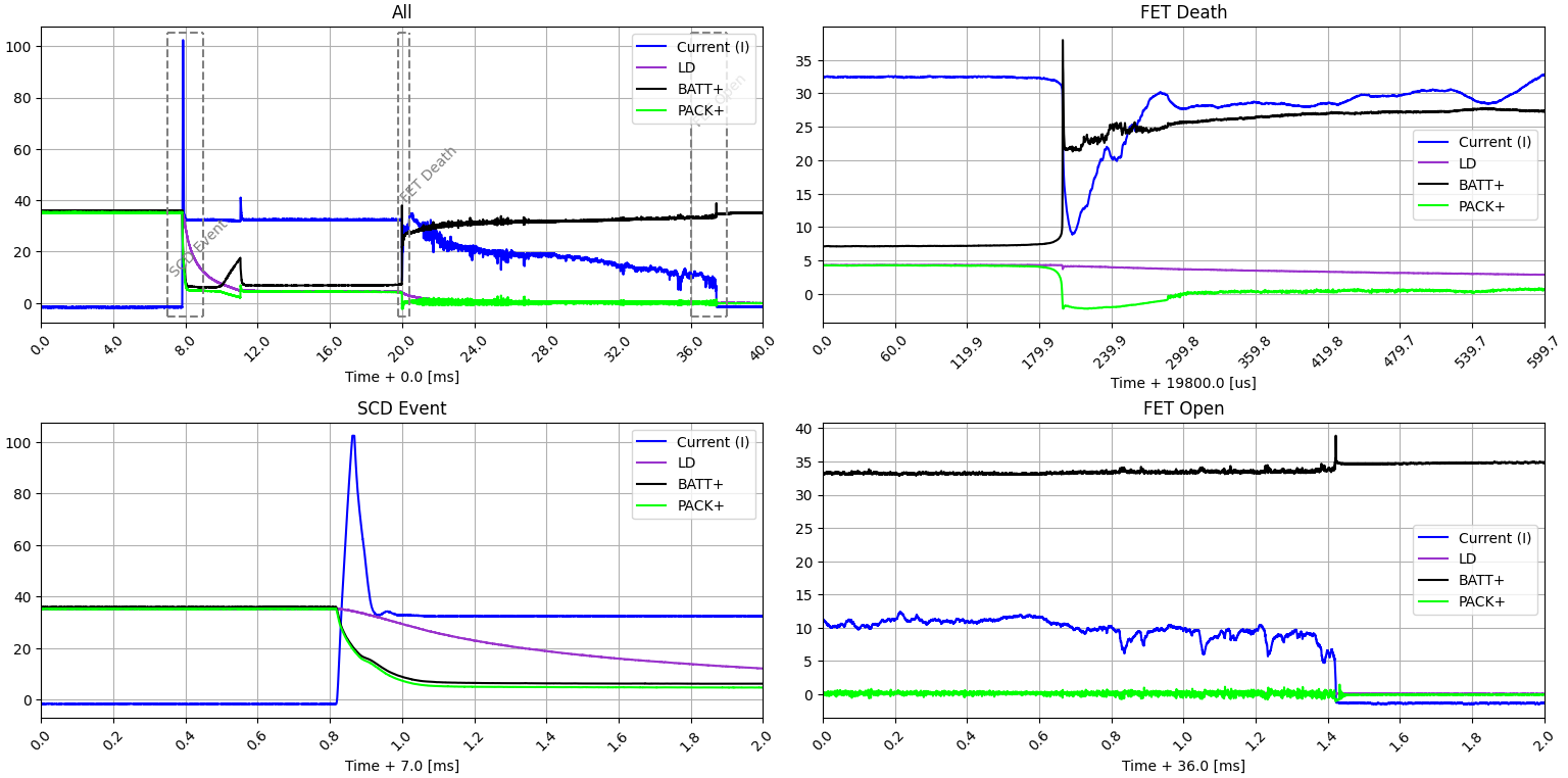

  • Hi Luis, hope you had a nice holiday season.
    1. The FETs in use (SIR680DP) are capable of 200A for a 100uS pulse, our SCD peak is significantly lower than this time window. If the gate voltage would continue clamping to 0 instead of stopping at ~18V then we would definitely be in the SOA of the FET.
    2. We are collecting new data on PACK/BAT voltages under these conditions, this isn't the greatest plot but I already have it and it shows that the BAT+ voltage does not spike severely enough to cause any damage? Please correct if I am wrong. Like I say, we will collect new data which will be more clear. Please note the FET is the SIR680DP NOT SIR180DP, please ignore that part number on the schematic.
    3. All of the data we have already provided shows no fluctuations in the voltage on the gate of the DSG FET which would rule out oscillations in my eyes?
    Ben
  • Hello Ben,
    In the new data, if possible it'd be great to also get the LD voltage during the event. I am curious on it.
    In my own testing of SCD protection I've seen voltage transients of almost 3 times the battery voltage when SCD turn-off speed is too fast, so do record what is happening with the transients. By the way, what protection settings do you have for this? We've suggested MOSFETs with drain-source ABS max of at least two to three times the overall stack voltage because of this.
    Some MOSFETs may be able to handle the transient better than others.
    Yes I agree about it not being due to parasitic oscillations, just mentioned it as it is something that we've seen to cause failures in the past.

  • Luis,
    We have re-run the testing to collect the data as requested, please see the plot below which is very similar to the original I sent:
    You can see that this data shows that we're not having any kind of severe transients.
    To make it easier, I have a separate plot here that just shows LD and Current in these scenarios:
    You can see LD discharges when the protection kicks in and then sits at ~5V until "FET Death"
    I have attached our config for you to look at too:
    bq76952-rev6.3-test1.gg.csv
    If you need any more data, please let me know.
    Ben

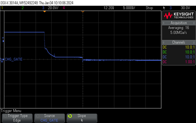

  • Sorry Luis, I realised I should have sent the gate voltage plot at the same time. This is from the test mentioned in my most recent post:
    Ben
  • Hello Ben,
    It seems like the SCD condition continues for over 10-ms until FET failure. There is still a ~30-A current and the BAT voltage is very low (due to battery being shorted). Did you see the fault trigger in the registers? If the FET is turning off (Which the original images seem to show the gate-source were the same, so FET is OFF), why would there be current flowing?
    Is the gate-source of the FET actually low enough to turn-off?
    The voltage transient on BAT does not seem like a problem.
