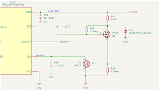

Hello.
Is this circuit working well?
I aim to construct a circuit breaker with a maximum current rating of 3A using the TPS259470L
I need AUXOFF Function.
or
Do you have a better idea?
(is it OK ,Just connect a diode between FLT and ILIM?)
Hi YuYa,
I will recommend simulating it using Pspice for TI.
Kunal Goel
Yes, I have tried Pspice for TI.
It seems to work well when I use the low-leakage model for NMOS with Drain-Source leakage current (IDSS < 0.1uA).
Additionally, it is necessary to change R67 to connect to VIN, not VOUT.

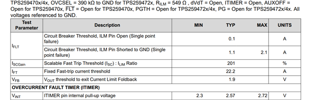

But, I can't comprehend its real behavior. Is it safe to short circuit the LIM?
What part of the datasheet should I refer to for my understanding?
