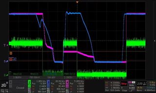

 My customer using LM5143 and found some funny issues.
1. 48Vin, 24V(Channel2) & 10Vout
2. If the Enable  signal takes precedence over Vin, Channel 2  of 24V will becomes 5V. and seems go into protection mode?   Channel 1 of 10V works well.
Green : EN
Blue: Vin
Purple: 24Voutput
Tks for your checking.

    Check the Thevenin resistance of the feedback network, as it must be > 5kΩ (otherwise it will detect FB low at startup and configure as a fixed 5V output). Also, I see the output is dipping negative right before EN going high, which may also be affecting this.

  • Allen,
    Go ahead and investigate Vout going negative just prior to the EN startup. This is the main difference relative to the VIN startup and likely causing FB being detected as low.
