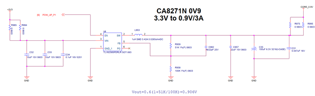

Dear Team,
Could you help to review the schematic as below? Thanks a lot.

Hello Jimmy,
Thank you for reaching out,
The below is the recommended LC filter combination. In the schematic I see a 22uF ceramic output cap and 100uF electrolytic output cap. For output capacitance higher than 47 µF, a feed forward capacitor is needed. And also the electrolytic cap will be having the higher ESR which may leads to higher ripple.
Thank you & regards,
Moheddin.
