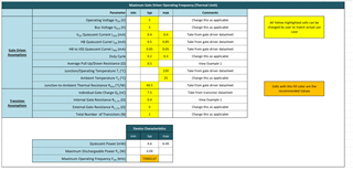

  • Hi, Wiliam,
    I tried the tool, with example of LMG1210 demo board, it shows this demo board can run at 70MHz, actually this demo board specifies 15MHz maximum, when i ran it, it shut down around 13MHz. Can you go though it and check where is the discrepancy come from?

  • Hey Shengnan,
    For your calculation, IVDD, IHB and IHBS are not the same as the datasheet. With that change, you get to around 52MHz from the calculator tool. As a reminder, this calculator tool is just a guideline to get you in the right direction and ball park of where you need to be and is giving the maximum frequency calculation.
    As for the shut down state that you saw with the EVM, from Table 1 of the user's guide, note 1 states "Using EPC2001 relatively large FETs limits the usable maximum frequency, smaller FETs allow operations up to 50MHz.

  • Hi, William,
    When running LMG1210 EVM, it shuts done beyond 13MHz, because of overtemperature protection of LMG1210. Nothing destructive.
    I understand that FET Qg plays a major rule, Qg higher, fsw is lower. That is why i want to use the EVM board to validate the calculation tool. However, there is a big discrepancy between them.

  • Hey Shengnan,
    As a reminder the calculation tool is just a guideline.
    Are you following the maximum frequency testing set forth by the EVM's Users Guide? This is located in Section 7.3.2.1 Maximum Frequency of the LMG1210EVM User's Guide.
    The limit to frequency is based on the current in the LDO and FET behavior. So, depending on your setup, you may be stressing or violating the setup's operating conditions for running at these high frequencies.
