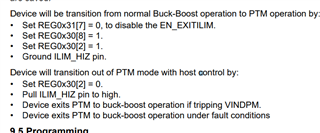

I found the BQ25710 PTM mode need some process to enable. But BQ25720 did not mention it, does BQ25720 activation require the same process?

For BQ25720, just the EN_PTM=1 will enable PTM. Let me know if you find any issues.
