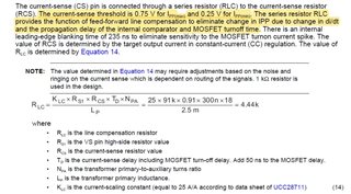

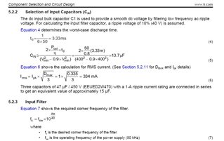

I wonder that how bleow equation is calculated. I mean that I cant unerstood of equation.
1. Here, td calculated 1/(6*50) which Equation 4. How come number 6, 50?
2. Below picture, the RLC calculated equation 14. How com this equation?

Thank you for the query on UCC28711.
1. 50 is the line frequency. I would encourage you look at datasheet equation 11 and calculate the capacitance.
The designer is no longer with TI so I cannot comment on the choice of number 6. Vbulk(min) is generally chosen at
0.7 times the minimum input voltage. I would encourage you to look at the following link page -13.
www.ti.com/.../slup302.pdf

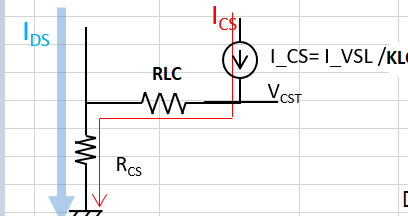

2. I will give an idea of this is done. You can do a formal derivation yourself.
VCST = (Ids+Ics)Rcs + Rlc*Ics
Ics = Ivsl/Klc (Klc is an internal current gain factor)
Ics = Vin/(Klc*Rs1*Npa) according to the current in the aux winding
(Vcst-Ids*Rcs-Ics*Rcs) = Rlc*Ics

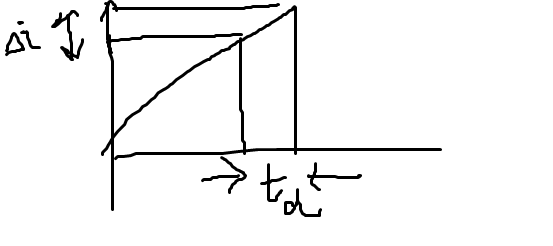

The left hand side of the above equation can be approximated as deltaI
deltaI*Rcs = Rlc*Vin/(Klc*Rs1*Npa)
deltaI/Vin = td/Lp
Rlc = Klc*Rs1*Npa*Rcs*td/Lp
