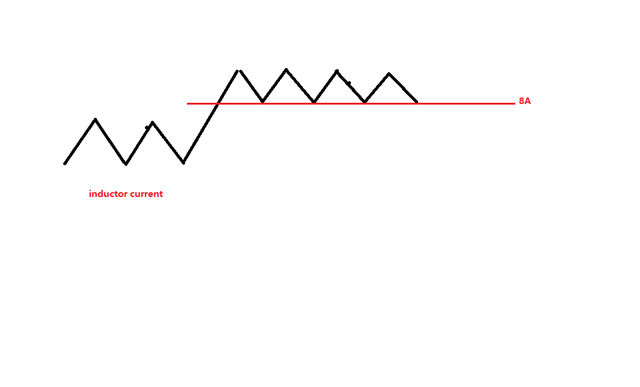

    Please correct me if I'm wrong in my understanding. Assuming we go with the recommend specs from the application section in the d/s whereby we have an input voltage of 2.7-4.35V, does this mean that the single-cell Li-ion battery used here needs to have a minimum discharge current of at least 6.7A?
    Or does the TPS61022 regulate the current across the inductor which is usually 8A no matter what the discharge current of the battery/input is?
  • Hi Lee,
    No. The 8A is current limit, it means when the inductor valley current is higher than 8A, TPS61022 will limit the current at 8A to protection the inductor and itself.
    The real inductor depends on your operation conditions, for example, if the battery voltage is 3.6V, output voltage is 5V, and the output current is 2A, the average inductor current is about 5V*2A/3.6V=2.7A, not 8A. But there is a very heavy load or the output is short to ground, the inductor current is possible higher than 8A, in these cases, TPS61022 will limit the inductor current.
