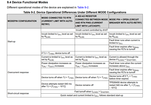

Hi Experts,
My customer needs latch-off when thermal shutdown occurs like mechanical fuse. Is it possible?
Uchikoshi
Hi Experts,
Uchikoshi
Hi Kunal,
Sorry, my question was incorrect. How about at short-circuit event? Can it be latch-off?
Uchikoshi
Hi Hisao,
In short circuit, irrespective of mode and variant device will retry once and after first TSD it will behave based on mode selected.
