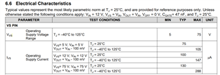

Hi Expert,
As this schematic if I change the VS to 48V or much lower.
Could you see any risk or not recommend in here ?
Hi Chao
VS pin can be powered separately. Please make sure it is higher than 5V.
Thanks and Regards
Shiven Dhir
Hi Expert,
If my customer want to use like VS pin connect to 15V
But his IN and OUT pin connect keep 54V.
This application will have any side effect or risk ?
