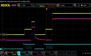

As shown in the diagram below, after powering up the PD Power Supply, there is communication between the PD Power Supply and the EVM on the CC line. This leads to voltage level changes on VBUS, ranging from 5V to 12V. Additionally, the PPHV path conducts when VBUS is at the 12V. Subsequently, VBUS power is shut down. Finally, VBUS voltage restarts and rises back up to 20V, with the PPHV path also conducting and outputting 20V.

    I've found that the power-on sequence of the PD Power Supply affects the VBUS power behavior.
    A. When connecting the Type-C Connector first and then plugging in the AC power, VBUS outputs 12V, then powers down and restarts.
    B. When plugging in the AC power first and then connecting the Type-C Connector, VBUS doesn't power down and restart, and the voltage level is correct.

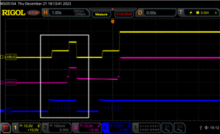

    When using just the Type-C connector and no barrel jack, I get the following (VBUS):
    When using the Type-C connector first, and then plugging in the barrel jack, I get the following:
    When using the barrel jack first, then plugging in the Type-C connector, I get the following:

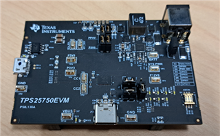

    I am using the EVM as seen below with the jumpers in their corresponding positions seen:

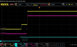

    I used the .json you provided and got the same result I provided earlier. Both methods:
    1. Using the EVM as a sink, and plugging in the Type-C connector to the EVM first, then plugging in the wall/outlet adapter to the outlet.
    2. Using the EVM as a sink, and plugging in the wall/outlet adapter to the outlet, and then plugging in the Type-C connector to the EVM.
    Resulted in the following signal for VBUS on both occasions:
    I also tried the same experiment with a different adapter, and a different cable (and also mixing and matching the originals with the new ones) and got the same result.
    Can you please let me know if I am doing something wrong in my testing procedure noted in #1 and #2, as I am trying to replicate what you are seeing? Do you still see the same result when you use a different adapter and/or cable?
