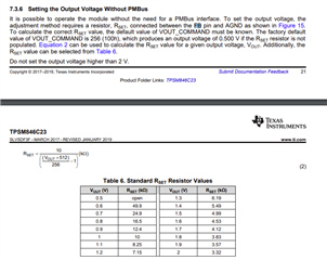

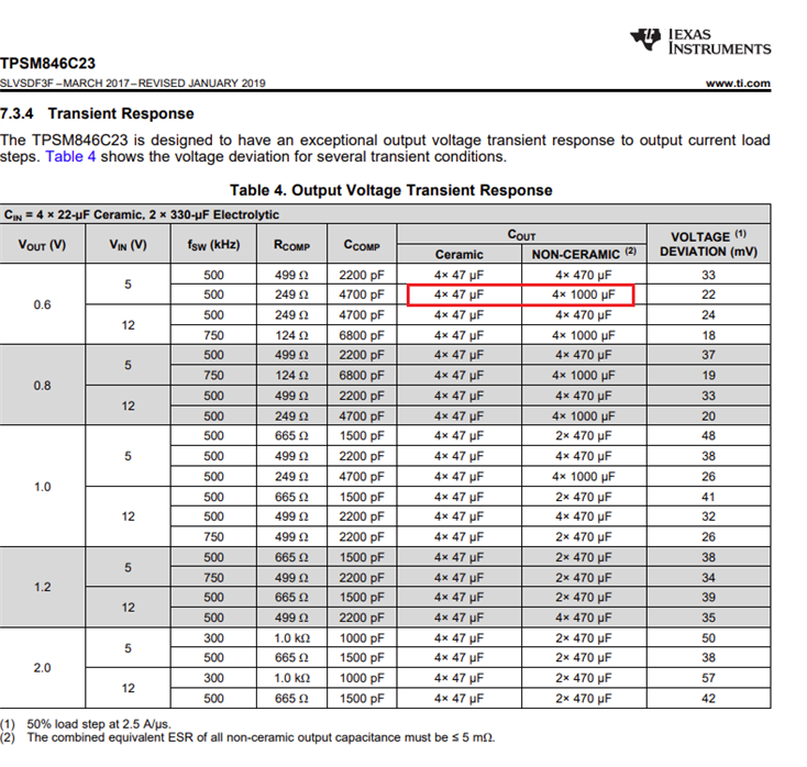

Hi Team,
I have done a high current step down converter design using TPSM846C23 power modules.Please see my below requirement and schematics capture for design 1.
Design -1
VIN=5V
VOUT=0.65V
IOUT=70A
FSW=500KHz
Vout allowable Transient should be less than 2% of VOUT(0.65V)
Schematics capture 5V to 0.65V @70A
/cfs-file/__key/communityserver-discussions-components-files/196/TPSM846c23_5F00_Schematics.pdf
Kindly check the above schematics and let me know your review feedback, can we achieve the transient response using above design compensation values?
Design -2
VIN=5V
VOUT=0.75V
IOUT=70A
FSW=500KHz
Vout Allowable Transient should be less than 2% of VOUT( 0.75V)
Can i use schematics 1 design for Design 2 requirement? Please let me know if there any modification has to done to meet the transient response?
