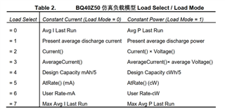

Could you pls explain how to calculate present average discharge current and present average discharge power
Whether the "present average discharge power" will be affected by "Avg I last run和Avg P last Run"?
Because the  customer is using Load select=1 , load mode=1,  they want to know in the rest status.
The discharge power is 0, then BQ40z50 how to calculate RM?
