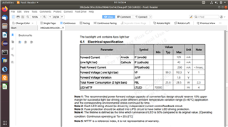

 I have used TPS61196 backlight driver IC for LCD display as per below requirement. I am giving 200Hz PWM signal and using 6 channels.I have changed the VOVP threshold value by changing the R3 resistor value to 360k. Also changed the R1- 100K,R2-22K,5R-220KE  .Vin is providing 24V. With these changes i am able to power ON LCD. But after power cycles  LCD is not getting power ON.  Verified VDD is coming 6V and Vref around 2.5V but Q1 is not getting switched. Due to this output voltage is coming 24V only. Remaining values are as per the datasheet. Please let us know what is the issue for IC to not working.
