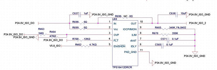

Hi Sir:
Please help to check if our schematic design has any problem.
Since now we can't get any output from TPS16412DRCR.
Now in no load condition we can only measure about 0.5V from the out pin (10).
What might be the problem or we're missong something here?
