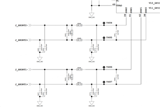

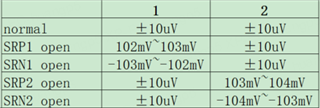

Hi, experts:
During the current CS_OPEN diagnosis, theoretically the sampling value of broken channel 1 or channel 2 will reach 275mV. The actual test is about 100mV. Please help to determine whether it is normal.

Hi Peng,
I've scheduled some lab time this week to look into this.
