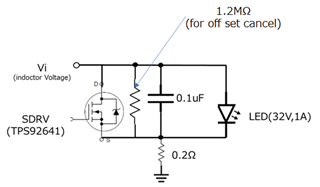

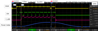

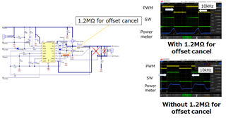

    The fig2 is PMW for SDIM input mode I think. As for the figure, using shunt FET The Current can be swiched. So that, if the resistor(for offset cansel_fig3) is attached, the response will be slow. if the Shunt FET's capacitor is 0.1nF,the time constant will be 0.1n×1.2M=0.12ms.
    Are these explanation is correct?
          fig1.original picture of the oscilloscope capture
                       fig2.switching current on SDIM mode
                     fig3. circuit attaching the registore for offset cansel

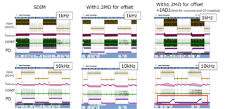

  • Please see the attached chart with measurements.
    From this figure, I had misunderstood. I would expect this delay to be caused by installing the capacitor(C_9) for IADJ, not by with the resistor for offset cancel.
    Do I still have to implement C_9 for IADJ to follow the datasheet?
  • Hi Takeshi,
    Thanks for the info. The thing is clearer now.
    When using the shunt FET, during the LED-off cycle, the output capacitor is discharged to almost 0V. During the LED-on cycle, the output capacitor is re-charged to the target voltage level (LED string voltage). The larger the output capacitance, the longer it takes for the output capacitor to be re-charged.
    When the C9 is not installed, the original output capacitor on the EVM is only 0.1uF (C5), which will not take much time when you re-charge the output capacitor when turning on the LED.
    When the C9 is installed, the output capacitor on the EVM is will be 0.1uF (C5) // 1uF (C9), which will take more time when you re-charge the output capacitor when turning on the LED. And this should be the reason why you see the slow response, especially in 10kHz PWM dimming condition.
    The thing is not related to the offset canceling resistor, R_OFF.
    I do not recommend using large output capacitance when doing shunt dimming as this large capacitance will greatly increase the LED current ramp-up time.
    Steven
