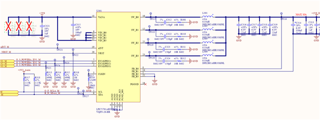

Hi TI engineer,
   We want to test Phase Margin and Gain Margin for LP875701,  but we found there is no feedback  resistor circuit,so can you tell us how to do the BODE test ,and how to change the feedback circuit parameters

  • Good Morning Yepeng Zhang,
    The feedback network of the bucks in this PMIC are internal in this design. To obtain the measurements you would need for gain and phase margin, you would need to insert a resistor into the FB pathway. For these PMICs, we tend to rely more on step response for our stability testing so I don't have extensive insight on the Bode plot measurement technique.
    Here is another E2E thread with additional information (it is a different part, but a similar situation as the feedback network is internal to that part as well).
    And here is an application note detailing the measurement further (specifically section 4.3).
