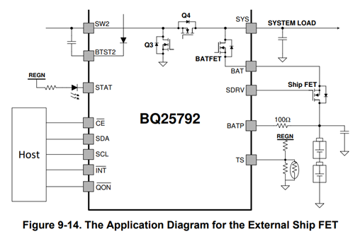

Ship mode :
To extend battery life and minimize the system power loss when system is powered off during idle, shipping or storage, the device can turn off BATFET and external ship FET to minimize the battery leakage current. The ship mode is enabled when the host sets SDRV_CTRL[1:0] to 10. The I2C is still enabled, but the charger system clock slows down to minimize the device quiescent current.
  • Q3 : If Ship FET turn off which means that the battery can’t provide the power to MCU, how can we disable the MCU. Do we need to feed Vbus to BQ25792 and let BQ25792 disable the ship mode?

    Regarding Q3, no. The charger's I2C is powered from BATP pin, which is always connected to the battery pack.  The charger has a built in 10s delay after the MCU tells the charger to turn off the shipFET.
    Jeff

  • Hi Jeff,
    Thank you. May you share the common use case that customer enable/disable ship mode?
    One idea from me is that pull high QON(bar) pin to VBAT. (enable ship mode).
    When 12V vsys into BQ25792 and then use MCU send low signal to QON(bar) to disable ship mode.
    How do you think?
    Roy
  • Hi Roy,
     An I2C write is to SDRV CNTRL register is required to enter ship mode after VBUS is removed. /QON is internally pulled high and can be pulled low to exit ship mode.
    Jeff

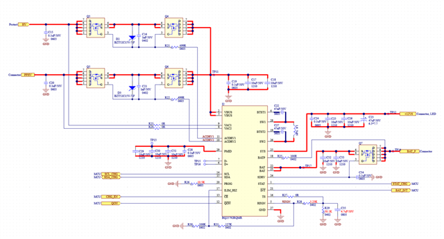

    May you help check the schematic for me? This is my first time to design the power bank EE, may you help check more detailed for me? Thank you.
    1. Is it correct of the MOSFET for ship mode? BAT_P is positive of battery.
    2. Is it possible to simplify the input side MOSFET?
    3. Our charge current would like to set 1A. Is the resistor and mode setting correct?
    4. For charge voltage, is it defined by I2C? We would like set it as 12.6V
    5. We plan to set TS as fixed resistor, we would like to dynamically control the battery charge current/voltage by our MCU instead of battery charger, is it ok?
    Roy
  • Hi Roy,
    On the schematic, C35 must be connected to REGN not TS.  Also, C34 on SDRV is not needed/recommended.
    Regarding 1, yes.
    Regarding 2, if there is the possibility of both inputs being connected at the same time, no.
    Regarding 3, yes. PROG pin resistor = 10.5k sets default BATREG=12.6V and ICHG=1A.
    Regarding 4, see 3 above.
    Regarding 5, yes.  You can use to equal resistors for the TS pin divider if you want to disable it.
    Jeff
