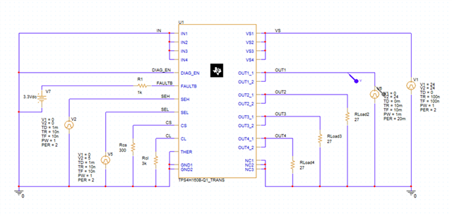

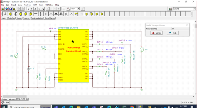

while Simulation using pSpice model TPS4H160-Q1, found result of leakage current is not matching with datasheet. As per datasheet it should be 3uA but we are getting only 40pA to 50 pA.
will you please help on this.

  • Hello Shreya ,
    Thanks for details. Below setup we done on actual board and model
    Please find below observation found between Pspice model and PCB board setup.
    Device PCB Board Setup observation

    please let me know if anything needs to update in model.
    Thanks ,
    Abhilash Patil
  • Hi Abhilash,
    This seems to be a bug in the model. Please only use the model as an abstraction of the device to check its behavior as it drives a load.
    Shreyas
