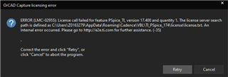

When I install Pspice in my computer, there is below error, could you help to check what's the reason?

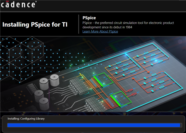

Hello JC,
I don't connect VPN when installing it, below is the block process. Always stay this state, not to next step, why? What should i do?

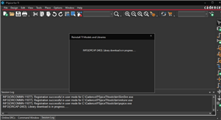

When i start Pspice, session log see below
INFO(ORCOMMN-11077): Registration successful in user mode for C:\Cadence\PSpiceTI\tools\bin\orpicis64.dll
INFO(ORCOMMN-11077): Registration successful in user mode for C:\Cadence\PSpiceTI\tools\bin\orpiica64.dll
INFO(ORCOMMN-11077): Registration successful in user mode for C:\Cadence\PSpiceTI\tools\bin\orpiPIC64.dll
INFO(ORCOMMN-11077): Registration successful in user mode for C:\Cadence\PSpiceTI\tools\bin\orpiPspice64.dll
INFO(ORCOMMN-11077): Registration successful in user mode for C:\Cadence\PSpiceTI\tools\bin\orApConCtl64.dll
INFO(ORCOMMN-11077): Registration successful in user mode for C:\Cadence\PSpiceTI\tools\bin\orgenlibcom64.dll
INFO(ORCOMMN-11077): Registration successful in user mode for C:\Cadence\PSpiceTI\tools\bin\ortruereuse64.ocx
INFO(ORCOMMN-11077): Registration successful in user mode for C:\Cadence\PSpiceTI\tools\bin\PspiceExplorerSrvr.exe
INFO(ORCOMMN-11077): Registration successful in user mode for C:\Cadence\PSpiceTI\tools\bin\simmgr.exe
INFO(ORCOMMN-11077): Registration successful in user mode for C:\Cadence\PSpiceTI\tools\bin\SimSrvr.exe
INFO(ORCOMMN-11077): Registration successful in user mode for C:\Cadence\PSpiceTI\tools\bin\mrksrvr.exe
INFO(ORCOMMN-11077): Registration successful in user mode for C:\Cadence\PSpiceTI\tools\bin\pspice.exe
INFO(ORCAP-2463): Library download is in progress.....
ERROR(ORCAP-2466): Reinstallation of libraries could not be started. Try reinstalling libraries later.
INI File Location:C:\cds_spb_home\cdssetup\OrCAD_CaptureTIPSpice_Install/17.4.0/Capture.ini
Hi Cynthia,
Another individual had a similar issue. They had to turn off their Proxy under internet options in control panel
Can you give that a try?
