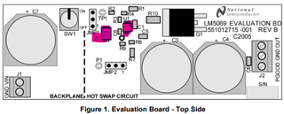

in my customer's application, there is long distance between Vin to Rsns which can bring parasitic inductance. so my customer want to put TVS close Rsns in case there is large voltage spike during Vout short. Is it OK?
I do not see guide on TVS position in datasheet.  Thanks.
