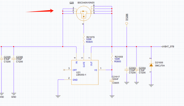

As shown in the figure below, can two MSO tubes be connected in parallel to increase the current at position Q28?
Hi Jeno
Thanks for reaching out to us!
Yes, you can connect parallel MOSFETs to increase the current carrying capacity. Please note that the turn on time of the FETs will increase as equivalent gate capacitance has increased.
