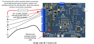

BQ76952 using in 15s battery,The AFE circuit of our product is referred to the recommended circuit below
we test cell1-13 balance is OK,but can not open cell14 and cell15 balance,may i ask how to open cell14 and cell15 balance
Hello Xiang,
You must also ensure to change the Settings:Configuration:Vcell Mode register for 15 cell configurations. Else things may not work properly. In this case Cell 15 would have to be put as not being used.
Did you do this?
