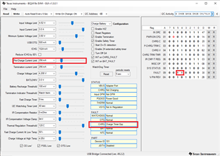

    i've investigated further my problem with the Precharge current and Safety timer and it's look that the problem occur due to the control of the charger through GasGauge.
    I've diconnected on my PCB board the communication interface between Charger and GasGauge and connected directly to the PC through USB Adapter Interface.
    To control the charger i've used the bq2419x EVM-GUI software.
    First i change the precharge current from default value of 256 to 128mA and it's works when i change the battery voltage to 2.9V.
    Also the satety timer expired after 5hrs of charging and stopped it.
    What is your opinion?
    Alexandru Mixich
  • To your question from your previous post, the picture with bqstudio shows the bits from Reg8 of the charger showing "Fast Charging" is in progress.

  • Hi Anthony,
    i followed your suggestion and reconnect the charger from PC to gasgauge to see the behaviour.
    And for precharging i found the reason why it has not working. In Reg4 of the charger there is a Bit BATLOWV which set the threshold between precharge and fast charging. When connected to gasgauge this Bit was set to 0 meaning that precharge starts when Batt voltage is below 2.8V. When testing with my Batt. simulator i need 3.0V. But to change this Bit i need to use the Advanced Command. Using DataMemory is NOT working. It shows not the content of the Reg4.
    A second issue, observed during the test is that the precharge current will flow only if the voltage threshold is switched on/off. If the threshold value will be reached by changing the Batt. voltage from 3.8V for example  to 2.9V slightly the precharge current will NOT flow.
    Can you tell me please why i can not set the Bit 1 in Reg4 though DataMemory location?

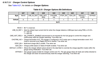

  • Hi Alexandru,
    I looked through the most recent version of the firmware and saw that the Reg 04 bits are represented correctly unlike the representation from bqStudio above. Can you please tell me what firmware version is being used on your gauge currently?

  • Hi Alexandru,
    Sorry for the inconvenience, would it be possible to try and write to the Reg04 location within the Advanced Comm Tab in bqStudio to see if this is able to change the BATLOWV bit?
    Anthony Baldino
  • Hi Anthony,
    with Advance Comm Tab it was possible to change the state BATLOWV bit.

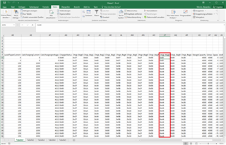

    2) The safety timer it's still not working. I attached the .log file taked for the whole period where charging was issued. The whole time the device was in fast charge phase and no actions were taken to reset the charging process.
    Please take a look over the log file. Maybe you can find an explaination for this strange behaviour.

  • Hi Alex,
    Thank you for the update. Just to confirm, the timer is supposed to alter the charge fault bit values in REG09 when the time expires, however these are being read in from the charger. Can you please confirm that the change in the charge fault bits are not being seen from the charger side as well?
    Anthony Baldino
  • Hi Anthony,
    what i can confirm is that when i use the charger alone, without the gasgauge, the timer expiration is marked in REG09 through the bits 5 and 4 which are set to 1.
    I'm not able to disconnect the charger from the gasgauge and continue directly the communication through a PC.
    You were able to go through the .log file?

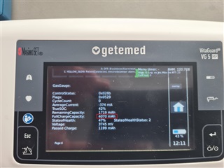

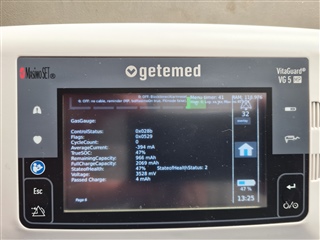

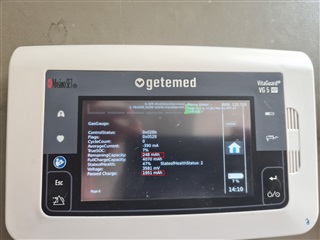

    i'm just wondering if you were able to get some clarification about setting the error bit in REG09 in case the charging time is expired.
    Second, with a device i have a strange behaviour. During the charging phase the FullChargeCapacity reach the desired value (4000 - 4100mAh).
    During the discharging phase, the capacity reached is about 2200mAh more less than the value showed by FullChargeCapacity - 4070mAh.
    The SOC value is showing 7% although the battery voltage is 3581 mV.
    When the device is switched OFF and after a time 30 - 60min again ON, the SOC value is around 50% at voltage of 3528mV.
    The stateofHealth is 2 over all phases.
    How it possible to have, at aprox. same voltage 3500mV, so big differences in the SOC value (7% and 47%)?
    I change the battery to exclude the possibility of a defect, but the behaviour was the same.
    I have to mention that this behaviour exclusivelly happens only at one device. Other devices works fine but have for StateOfHealth the value 3.

  • Hi Alexandru,
    Sorry for the delay, regarding the REG09 issue, I have not received a response so I will reach out to a different member of their team for their assistance. Can you please confirm if the [BYPASS] bit below is set?
    Regarding the issue of the differentiating SOCs, would you happen to have a bqStudio log file depicting this issue? This would allow us to look into the registers of the gauge to try and find the root cause of this issue.

  • Hi Anthony,
    the bit [BYPASS] ist not set  in our configuration because we decide for our application that the gas gauge should control entirely the charger bq24192.
    Alexandru Mixich
  • Hi Alexandru,
    After discussing this issue with our firmware team, is it possible to change the [BYPASS] bit to 1 and reattempt the test? They believe this could assist in relieving this issue.
