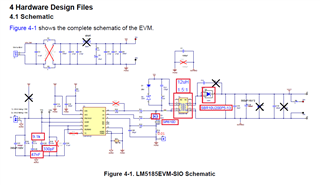

our customer is evaluating LM5185EVM-SIO and modify EVM support below requirement.
Vin=12~57V, Vout=12V, Iout=2.5A
We have modified EVM circuit VFB resistor and got 12V output, however output current limit at 1.2A.
We tried parallel two Rshunt resistor (0.02 ohm) but current still limit at 1.2A.
Is there other circuit we need to modify? Can LM5185EVM-SIO transformer support 2.5A output?
