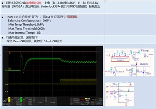

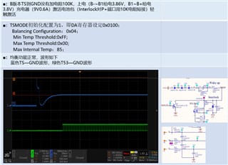

The customer is using BQ76905 to test the cell balancing function.
When TS mode is set 0; the cell balancing function is normal.
When TS mode is set 1; without 100kΩ to ground in TS pin, only 3 diodes to ground. the cell balancing function is normal.
When TS mode is set 1; with 100k to ground in TS pin, the cell balancing can not operate.
The customer need the 100kΩ.
Could you pls tell me why "When TS mode is set 1; with 100k to ground in TS pin, the cell balancing can not operate" ?
Whether this is the internal cell balancing algrithum?
Could you pls help to reproduce this in our EVM board?

  • Hi Luis,
    The diodes is to make sure the TS could wake up BQ76905. Because the diode turn-on voltage is higher than 1.2V.
    The TS pin voltage below 0 is because of the capacitor C5,which is used to avoid the unintentional wake up.
    The other picture shows: When TS mode is set 0; with 100kΩ resistor, the cell balancing function is normal.
    So the under 0 voltage is not the reason why cell balancing do not work.
    Could you pls help to check the internal cell balancing algorithm?
    What could be the reason?

  • Hello Fabio,
    I appreciate the patience! I was able to recreate the cell balancing stopping on an EVM when ADCIN is configured on the TS pin.
    If the ADC TS Measurement (See image below) reads negative, it will cause cell balancing to stop.
    A work-around to stop this is to add an offset to the TS pin as such the TS Measurement() does not read negative.
    This can be -10 or -100, depending on how low the measurement is reading. The offset can then be re-adjusted on the MCU-side.
