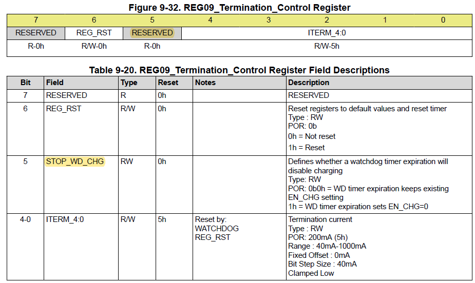

Hi Jeff-san,
When will the data sheet be updated?
Bit-5 in Figure 9-32 is RESERVED, but it is STOP_WD_CHG, right?
One more in
Kagawa
Hi Kagawa,
Thanks for pointing out the RESERVED typo. I have provided all of the known datasheet errors from the list in this e2e post. Even if submit the datasheet changes today, they will not be reflected on the website for at least 1 month if not longer due to our datasheet change process and required approvals. That is why we only make datasheet changes after we have accumulated several, unless they affect the electrical spec table's warrantied values.
