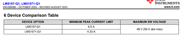

    LM5157(1) has the following max current values given by the datasheet:
    For a worst case situation of min Vin and max load, there can be peak inductor currents up to 9A.
    This calculates from the average inductor current + the switching current ripple. This peak inductor current needs to be below the current limit of the device.
    Therefore, this device is not fit for the application. You could switch to the LM5155 device, which uses an external FET instead and does not have this current limitation.
