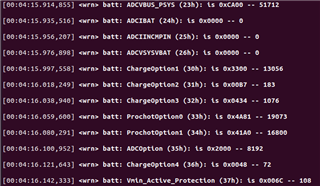

  • Address Command Registers Default Values Values From Logs
    12h
    ChargeOption0
    E70Eh
    870Eh
    14h
    ChargeCurrent
    0000h
    0600h
    15h
    ChargeVoltage
    3138h
    20h
    ChargerStatus
    0000h
    8000h
    21h
    ProchotStatus
    B800h
    B800h
    22h
    IIN_DPM
    4100h
    4100h
    23h
    ADCVBUS/PSYS
    CA00h
    24h
    ADCIBAT
    0000h
    25h
    ADCIINCMPIN
    0000h
    26h
    ADCVSYSVBAT
    0000h
    30h
    ChargeOption1
    3300h
    3300h
    31h
    ChargeOption2
    00B7
    00B7
    32h
    ChargeOption3
    0434h
    0434h
    33h
    ProchotOption0
    4A81h(2S~) 4A09(1S)
    4A81
    34h
    ProchotOption1
    41A0h
    41A0h
    35h
    ADCOption
    2000h
    2000h
    36h
    ChargeOption4
    0048h
    0048h
    37h
    Vmin Active Protection()
    006Ch(2s~4s)/0004h(1s)
    006Ch
    3Bh
    OTGVoltage
    09C4h
    3Ch
    OTGCurrent
    3C00h
    3Dh
    InputVoltage
    VBUS-1.28V
    3A40h
    3Eh
    VSYS_MIN
    5C00h
    3Fh
    IIN_HOST
    4100h
    4100h
    The above images were logs while reading respective register addresses from BQ25720.
    NOTE:- All values read are default form the IC except:-
    IIN_HOST - 4100h (3250 mAmp),,
    VSYS_MIN - 5C00h (9200 mVolt),
    ChargeOption0870E (set watchdog bits (14-13)  to 00),
    ChargeVoltage - 3138h (12600 mVolt)
    ChargeCurrent - 0600h (1536 mAmp)

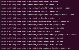

    And the below image showing the FuelGauge (bq40z50-R1logs.

  • Hi Arpan,
    Thanks for the register map. The charge status register does not show any fault. It also shows that the charger is not neither in pre-charge nor in fast charge. Which leads me to question
    1. what is the battery voltage when you are attaching it to the charger? Are you attaching a battery with 0V?
    2. assuming that you are using a battery with non zero charge voltage and since you are measuring 0V from VBAT to GND, I believe the fuel gauge schematic needs to be checked by someone from fuel gauge support. We also need to check how the fuel gauge is connected to the charger.
    3. and this is a sanity check. You are charging a 12.6V battery with 1.536A charge current (according to the register map), your output power is at least 19.35W. Make sure that the input power is higher than this. Otherwise, charge current can drop to zero.
    Munir

    I have reviewed the schematic. The charge controller part looks ok. However, the fuel gauge does not look like bq40z50-R1 and I cannot verify that schematic. Your schematic shows part number CW2015CSA. I am wondering if the resistor divider on the fuel gauge cell pin is responsible for discharge.
    How long does it take for the battery to discharge from 11.4V to 0V? Is it very quick?
    Can you try charging the battery without the fuel gauge and see if there battery discharges as well? I would like to identify if the fuel gauge is causing this issue or not. Please, disconnect the fuel gauge from the charge controller and test battery charging.
