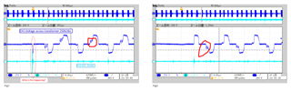

The waveform in Fig1 can be seen every few times during burst mode under light load.
What is this happening?
I usually use Fig2 most of the time.
Is this normal? Are there any countermeasures?
I'm working on increasing the efficiency of light loads.
I think it would be even better if this was removed.

    Please note both of your waveforms have excessive ringing on the transformer that should not be present.  You may want to figure out what is causing this ringing and remove from your design.  This could be caused by layout/schematic errors.
    In Figure 1 you are correct that the polarity across the transformer should change every other cycle including burst mode.  So you should not see that behavior.

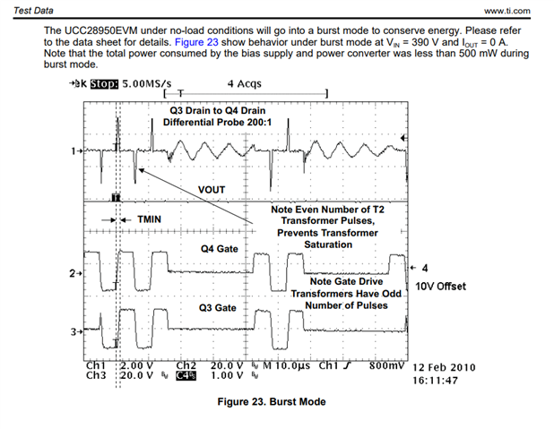

    There is a 600 W reference design using the UCC28950, UCC28950EVM-442 that you may want to order and evaluate. The following link will bring you to the user's guide for this evaluation module.  There is a schematic, layout and test data in this User's Guide that you may want to evaluate.  https://www.ti.com/lit/ug/sluu421a/sluu421a.pdf
    The waveform below was taken from the 600 W UCC28950 evaluation module. CH1 is the voltage across the transformer and shim inductor.  CH4 is the CS signal and CH2 and CH3 are the low side FET gates.  From these waveforms you can see there is not excessive ringing that is present in your waveforms.
    The User's guide has what the behavior should look like in burst mode.  Below in figure 23 is the behavior that you should observe in burst mode.  The voltage across the transformer should change polarities every other cycle.
    When looking at your waveforms in light load burst it looks like you minimum duty cycle is set for 40%.  This is kind of high and may be causing some of your issues.  Pin Tmin of the UCC28950 sets the minimum duty cycle before bursting.   You might want to set RTmin to 10 k ohm to see if the issue goes away.  This will give a minimum duty cycle of 50ns*(switching frequency) before bursting.

  • Hello
    There was a lack of explanation.
    This power supply is a variable power supply.
    The maximum is 120V.
    The waveform this time is the waveform when the output is 50V/0.1A.
    I thought that because the OFF period was long, the energy of L on the secondary side was gone and it was resonating.
    Is it abnormal even considering the above?

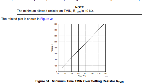

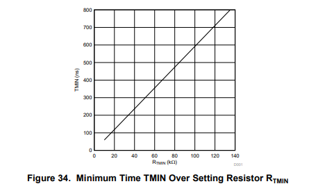

    RTmin value is 15kΩ.
    However, the ON width is approximately 1.44usec.
    Even if you lower the resistance value, it will not become any shorter.
    What is it attributed to?

    You could be right about the inductor resonating because the inductor is gong DCM.   You can verify this by studying the inductor current versus the waveform that you have taken to verify this.
    The shim inductor will form a voltage divider with transformer primary magnetizing inductor.  As long as the value is not too large it should not cause an issue.  I would think if it was 10% or less compared to Lm it would not cause an issue.
    If your RTmin is set for 15 k ohms your minimum voltage applied the transformer should be 75 ns.  Even though the controller is bursting it may not be due to light load bursts controlled by tmin pin .

    In your first waveform you have OUT B, Out C and the transformer input voltage.  This waveform does not show B and C on at the same time that corresponds to voltage across the transformer.  Are you sure this is Out B and Out C in this waveform?  If it is you have something connected wrong in your H Bridge.
    The second waveform has OUT A, OUT C and the transformer voltage.  This will not show when voltage is being applied across the transformer.  You would have to look at OUT A, OUT D and the transformer input voltage.
    The voltage across the transformer should align with the A and D outputs and the B and D outputs.  When A and D are on at the same time there will be voltage applied across the transformer.  When B and C are on at the same time there will be voltage applied across the transformer in the reverse direction.
    In regards to the behavior typically voltage across the transformer will alternate.  In the waveform you are showing there appears to be a small duty cycle in the negative direction.  Shortly after it is negative again for the normal duty cycle.  Having voltage applied  transformer applied in the same direction  for two consecutive cycles is not normal.

    ① Is there any problem if I set TMIN to 1usec? (RTMIN:100k to 200kΩ)

    1. In regards to setting the minimum TMIN I would recommend only using resistors between 10k and 135k ohm.  This is where TMIN was characterized.

    Could you verify that it is light load burst mode.  Study CS, COMP, SS and transformer input voltage when the design is bursting?

    If the output voltage range is wide, we have determined that it is difficult to achieve ZVS in all areas.
    Currently, when the output is low, there is a large loss when the load is applied to 10 to 40%.
    QA and QB are especially hot.
    As a countermeasure, increasing the L value of the Shim Inductor will give good results.
    However, as the LS value increases, the FR also increases, so the calculated TABSET and TCDSET values also increase. Please let me know the disadvantages of setting the DelayTime shorter than the one calculated here.
    Currently, I am thinking of changing the calculated value of 170nsec to 70nsec.
