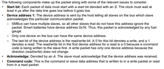

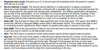

Hi expert.
After write Data Flash via EV2400,
I want to change Design Capacity value via MCU. (addr 0x4b69)
If this is possible , please let me know SMBUS protocol.
(ex, 0x16-0x44-0x02-0x49-0x4b ..)
Below is the SMBus communication structure from our SMBus Made Simple document:
https://www.ti.com/lit/pdf/slua475
This document also contains how each of the SMBus packets are broken down:
