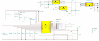

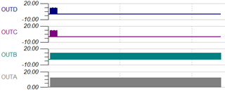

I have been working with the UCC28950 in TINA and cannot figure out why OUTC and OUTD are not switching. OUTA and OUTB are switching as intended. OUTE and OUTF are not switching either, but I chalk that up to issues with the C and D outputs.

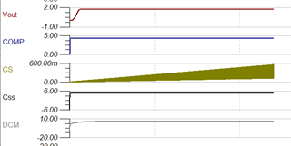

After successful soft startup, the signals are constant as follows:
COMP: 4.25V
DCM: 5.55V
SSEN: 4.65V
TMIN: 5V
VREF: 5V
Thank you in advance
