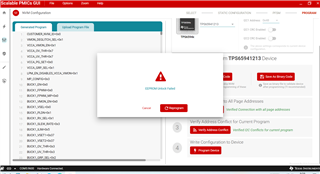

TPS6594-Q1: PMIC unstable connection to computer through GUI, after connector succeed occaslonally, burning NVM code by GUI, reporting EEPROOM unlock fault, unable to perform flashing
Part Number: TPS6594-Q1
Other Parts Discussed in Thread: MSP432E401Y, UNIFLASH
Question 1:
Through the debugging board of MSP432E401Y MCU Launchpad, the TPS6594 chip is connected through GUI. The output connection is unstable, sometimes good and sometimes bad, and the I2C pull-up resistor is 1.5K. It can connect to the MSP432 board, but cannot connect to the chip. The latest GUI version used is 4.0.

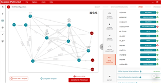

Question 2:   In the GUI, when I loading the configuration template for J721E, two errors were found during PSFM verification, namely act2socpwerr and any2act.

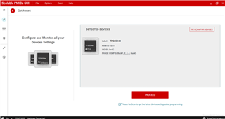

Question 3: Occasionally, after successfully connecting the TPS6594 chip, the quick start button automatically recognizes only one chip during device operation. The address of the chip is 0X4C. The other chip cannot automatically recognize.
Question 4:  After successfully connecting one chip, the template configuration of J721e was burned, and it could not be burned. A fault was reported that EPROOM  unlock failed. A multimeter was used to test the actual output of the chip, but the actual voltage of the chip was not displayed, so NVM was not burned successfully.
Please help resolve the 4 issues as soon as possible , Thanks very much!

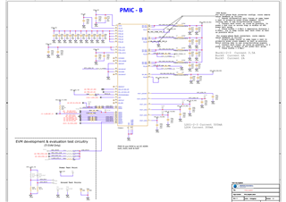

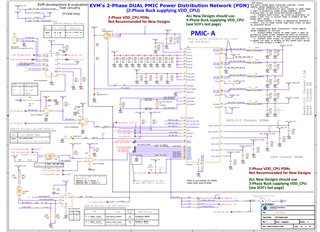

  • The SCH of TPS65941213 and TPS65941111 as fllow:

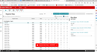

  • Does anyone help me to  solve  the "EEPROOM unlock failed" problem ? This error still exist. Thanks.

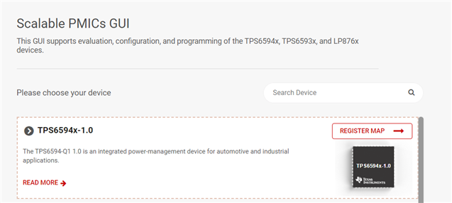

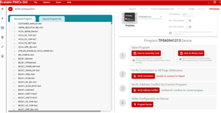

    The second question is, this setup, looking at the part numbers I see TPS659413 & TPS659411, is this correct?
    If yes, the GUI currently only handles 2nd revision silicon after adding improvements, the previously mentioned part numbers are for 1st revision silicon and you will need to use an older GUI in order to communicate properly with it.
    Try it with version 2.0.0, use it with the following link and click the TPS6594x-1.0: (click me for link)
    Again since this is older silicon and the current GUI doesn't handle it. Could you try again with the linked above GUI
    Same as above.

  • Thanks Nicholas, The TPS6594 is not Tps659413 of SCH view , it havs change to the TPS65941213 and TPS65941111.

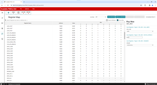

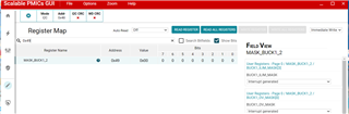

  • All of the registers is not empty when the first power up and connect success. I can read and write the USER_EE_CTRL_1 registers.  Order write 0x00.0x98,0xB8,0x13 ,0x7D than the USER_EE_CTRL_2 is not change to 0XC0, it‘s still 0x80.
    After I  down load the program ,all of the registers change to zero .

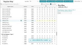

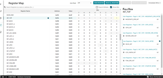

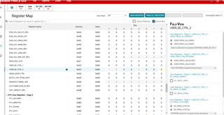

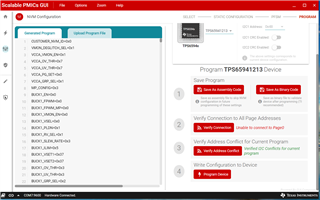

  •  As shown in register USER_EE_CTRL_2 of the picture, the NVM of the chip is locked ,prohibited programming?

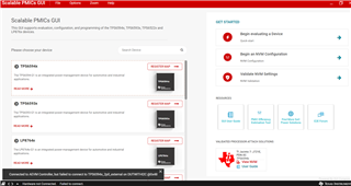

  • How to solve the problem of Unable to connect to Page0?
  • Hello Chenggang,
    Where are you getting your instructions on how to connect this launchpad to your development board?
    I want us to be on the same page.
    This is correct as you need to do a series of writes which the GUI will do for you, once it's able to connect.

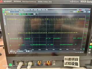

    You said the GUI connected, but the connection is spotty, have you been able to probe the lines with a logic analyzer?

    When powered on for the first time,  the GUI maybe could not be connected. I need to repeat power on.If the connection is successful and the state is stable.
    The urgent problem now is that I cannot “unlock the EEPROM" and "anable to connect to the page0". Can you help me as soon as possible?Thanks.

    The reason the unlock is not happening is that it is following the same set of 4 register writes to 0xA2 that are detailed out in this guide. (click link here for guide section 4)
    Normally the GUI does this for us.

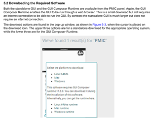

  • Hi, Nicholas

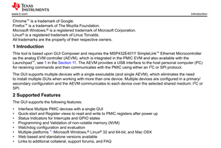

     1、please see the technical documentation of slvubt8b, it's show that of  use the  MSP432E401Y SimpleLink to do the debug.
    2、Download the GUI Composer Runtime and install the program.
    3、When I first setup a connection with the GUI through MSP432E401Y on my computer,The GUI will automatically prompt "Please update firmware”1.0.3.6“. I find this firmware in the Installation Path of GUI. C:\Users\Lucky\guicomposer\runtime\gcruntime.v12\Scalable_PMICs_GUI\app\fw
    I can't connect to TPS6594 now.  If i set of 4 register writes to 0xA2 still don't unlock the EEPROM.
    If my connection is incorrect ,Can you tell me the correct connection method?
    Thanks.

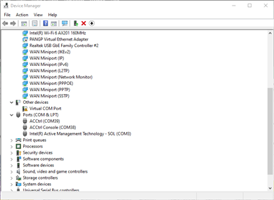

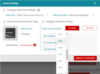

  • Hello Chenggang,

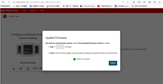

    I got my board to connect now with a boosterpack, but in order for the connection to work I had to flash via the GUI with a known good firmware installed via the GUI, not uploading one provided by myself.
    Please make sure you install the UNIFLASH tool as the GUI will do this for and will make the correct firmware is installed when asked to be updated:
    (click here for UNIFLASH installer download)

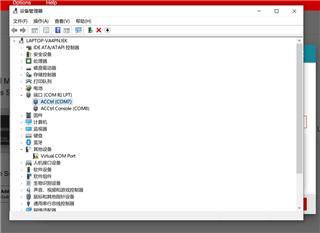

    Please make sure you're connecting via ACCtrl, not ACCtrl Console when inside the GUI.
    As for the I2C lines on the launchpad:
    PB2 is for I2C1_SCL1
    PB3 is for I2C1_SDA1
    Note the launchpad itself doesn't have pullups for these lines and will need to have them populated, if they haven't please make sure there is power on these rails along with having VIO & VCCA powered.

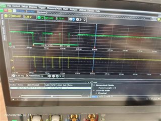

    Because when the GUI tries to do it from the user register GUI page, it performs the write and then immediately does a readback of the register to show the most up to date version on the GUI. When it tries to program it, the GUI does not perform these writes.
    As it says in the NVM update guide it needs to do these writes as four single back to back commands with no other read or writes inbetween.

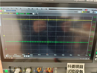

    Can you confirm you are getting a NACK, can you please a logic analyzer on the I2C lines?

  • Hello Chenggang,
    Please try the following.
    1. Ensure that the proper connections are made to the development board bus
      1. Have pull up resistors to VCCA voltage level
      2. Tie
        1. PB2 is for I2C1_SCL1
        2. PB3 is for I2C1_SDA1
        3. See the figure below the instruction for the connection done.
    2. Have Uniflash installed on your computer
    3. Load up the GUI
      1. Ensure that the correct com port is being used after connecting the MSP432 Launchpad
      2. Flash the MSP432 Launchpad with 1.0.3.6
    4. Reconnect the MSP432 launchpad to the computer & start the GUI once more
    5. Verify connection by doing a read all on the register page

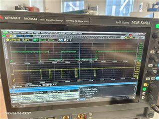

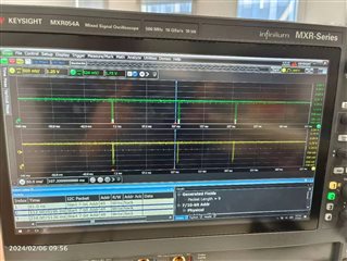

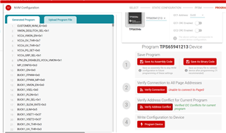

  • Hi, Nicholas
    Thanks for your details introduction. But the connection of TPS65941312 still has issues.
     1、My connecting via ACCtrl, not ACCtrl Console when inside the GUI.

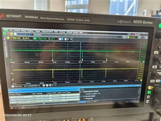

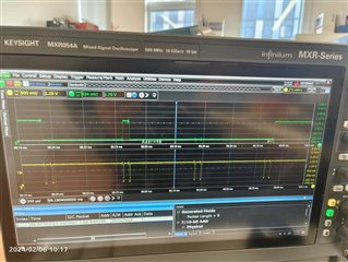

    2、I used PB2 is for I2C1_SCL1 ,PB3 is for I2C1_SDA1  and I2C's pullup res is 3.3K, but the 3.3K res is used R13 and R14 of MSP432 Launchpad
    3、I have install Uniflash on my computer, the frimware version has automatically updated to visversion is 1.0.3.6 via the GUI.
    4、All the states are correct when I connect to TPS65941111 via 0x4c address,I can capture the waveform of  I2C on the oscilloscope when I verify Connection via GUI .
    5、It's show that of  "PMIC I2C RESET " and "unable to connect pgae0"  when I connect to TPS65941213 via 0x48 address,I don't capture any waveform of  I2C on the oscilloscope when I verify Connection via GUI . It's show that of "Operation failed. Status = 4294959999" when i read the rigister.
    6、 I measured a voltage of 0.08V at location FB_3 pin  and 0.065V at location LDO4 output, Does this voltgae will  affect the connection to the GUI?
  • Hello Chenggang,
    Can you explain how? We did once offer an expansion for this particular EVM but we never used pullups located on the MSP432?
    I am just trying to make sure that the pullups being used have a stable connect, because at times I did have the pullups physically on the board and would get a connection but after looking an oscilloscope the connection was not reliable and when programming this could lead to errors.
    Wonderful! Glad to see that we're working with the same firmware from the same location.
    I know it may be difficult but please try, I understand you tried to program the PMICs, I would like to not think that the unstable connection might have done something wrong. I'm just looking for a ACK or NACK on I2C address 0x48 which would indicate that you could at least communicate with the PMIC therefor having a chance to reprogram.
    The 9999 ending of the code just means it can't communicate *VIA* the GUI, not that it's not programmable, again if the pullups aren't stable then no chance to connect relatiably.
    It shouldn't looks like it's just discharging from a power up attempt. No, but if you could make sure the enable PIN is low while VCCA is powered when you try to communicate with it that would be best.

    If you are able to connect to the TPS65941111, can you paste a screenshot of the registers of 0x5A to 0x6C, these interrupts will help me understand.

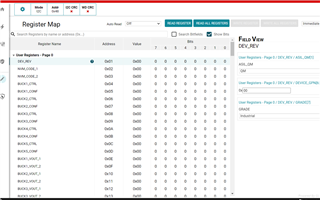

     1、The screenshot of  registers 0X5A and 0x6C is as follow.
    2. The input voltage after the FET for TPS65941213 is 3.3V, it's same to TPS65941111.
    3. Is there a default configuration for TPS65941213 and 1111 before leaving the factory? If i don't connect to GUI and pullup the enable PIN to 3.3V ,the chips is a automation work,the buck and LDO is output 0.8V,0.85V,1.8V and so on.

    5.  This new design  EVM version is refence to the part of  Jacinto 7 EVM's power and TDA4 SCH and has nothing change, only add some test circuit  unrelated to 6594.
  • Hi, Nicholas

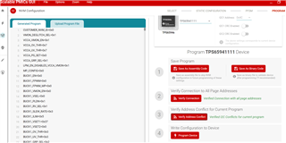

    I try to burn in 6594111 through GUI, it's show that of  successful ,but it cann't to connect through I2C adress 0x4C  than the GUI shows "hardware not connected" when power up again.
    The 65941213 also can connect via GUI with the IC2 adress 0x48.
    Gang
  • Hello Chenggang,
    So to understand that you have never been able to connect to the TPS65941213 via 0x48. But now after a flash of the TPS65941111 you are able to connect to TPS65941213?
    The EVM should have not needed any flashing on any of the PMICs.
    When you flashed did you make sure to select the proper the PMIC?
    As it's possible to flash your secondary PMIC (TPS65941111) as a TPS65941213, which is what I fear has happened. You may have connected to the 0x4C device and flashed it now as 0x48 device.
    If there are two functioning devices with the same address we can no longer tell what device is reacting to the commands.
    For a solution, you may need to replace a or both PMICs now.

  • Hi, Nicholas
    1. How can I connect to the I2C address of 0x49,0x4a?  There is don't have this two IC address selection in the GUI,and the I2C address cannot be manually entered in the GUI.
    2. I can only read the information of the two register addresses of 0x49 and 0x4a, shown it in the screens as below.
    Gang
  • Hello Chenggang,
    My apologies on that, using the GUI interface there isn't a direct way in order to connect to the I2C addresses of 0x49, 0x4A, or 0x4B due to the way the GUI hides the connection.
    If you have access to a logic analyzer, please probe the I2C1 bus and read the lines
    Upon trying to connect to address 0x48, the GUI will ask for a register read on address 0x49, as shown for successful connection.
    We are looking for a
    For a unsuccessful connection you will see the first connection for page1 (0x49) in red and
    followed by two attempts to connect to page 0 in yellow.
    If there isn't an acknowledgement after two attempts, the connection will fail and drop it. Please confirm that there is an acknowledgement in the red for the first I2C read.
    BR,
    Nicholas
  • Hi, Nicholas
    Thanks very much for your sharing, i will find a logic analyzer to test I2C1 but I need some time to find .
    Gang
  • HI, Nicholas
    1. It's  the I2C information as follw for 0x48 address , this stats  is don't connect to GUI.
    2. It's  the I2C information as follw for 0x4c address , this stats  is don't connect to GUI.
  • Gang,
    Firstly thank you for doing all of these test and I'm sorry to say if you're not receiving a ACK from the first device and it never responds. I'm going to say after the first flashing attempt the EEPROM may have been incorrectly written to with an unstable connection.
    Now if you can provide the specific part number for the Jacinto7 EVM we can see what to do from here.
    BR,

  • Hi, Nicholas
     Is that of  template "J721e_TPS6594" in the GUI correct?  Is it  really  can be uased ?
     I reference the design package of  "PROC078E8C_RP" and  "PROC079E3D_RP" .
    PROC079E3D(001)_SCH.pdfPROC078E8C(001)_SCH.pdf
    Gang
  • Hi, Nicholas
      I change a other EVM board" PROC112A1" of TI ,  have a same result as Jacinto 7 EVM.
     Is there any problem with the driver on my computer?
     Can you share with me the driver program for the virtual serial port?
     please share with me all the software drivers required to build this testing environment?
  • Hello Chenggang,
    I can redirect you to the processor team, but first I want to solve the issue of not being able to the PMIC.
    If the PMICs are not functioning then, it is not possible to boot up the the J7 EVM.
    PLEASE BEFORE FLASHING THE PMICs, can you tell me why you are flashing them, I highly recommend that you try it with a more stable connection.
    I notice still there are no pullups between the launchpad and the pins on PROC112
    I have the very same EVM.
    Please do the following in order to communicate with the device:
    • PB3 on launchpad to pin 3, J15 on PROC112
    • PB2 on launchpad to pin 1, J15  on PROC112
    • Connect the grounds between the boards Pin 2, J15 on PROC112
    • Shunt J21 on PROC112 in order to switch the external I2C lines
    Schematic for PROC112 (click here)
    Please try that before proceeding on, I don't want you to lose anymore time or money on boards if you don't have to.
     My setup and proof of connection:
    BR,
