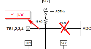

Hi Expert
When using Excel sheet for calculating Thermistor Coefficient,
what is R-PAD value of BQ40z80 ?
If set the R_PAD value to 2Kohm according to datasheet Fig. 6-3,
then the Coeff a2 value overflows.

R_PAD value should not be touched in the thermistor tool. It should be left as 0-Ohm. The 2k-Ohm is connected differently than what is shown in the thermistor tool.
