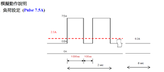

Hello everyone.
Discharge current bq27541-g1
[7.5A/1000μsec,0.8A/100μsec] <= 1200 repetitions + 0.2A/6sec
under the following conditions.
The GAUGE uptake current at this time is shown in the figure below.
When the battery was repeatedly charged and discharged under these conditions, the capacity was reduced to 2085mAh (81%) compared to the initial capacity value of 2570mAh after 600 cycles.
On the other hand, GAUGE's SOH is at 61%. (State of Health Load I is set to -7000).
How should I set the "State of Health Load I" to bring the SOH value closer to the capacity ratio (81%) in actual charging/discharging?
Please advise.
