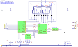

    Can you share your board schematic of the sense resistor?

    "Disconnected battery from the board before the test" means that we disconnected battery from the board because we needed to install thermistors between the cells and connected battery to the board again and performed the test. I thought that it was important to mention that gauge was disconnected from power supply for a while.
    I attached board schematic.

    Is SRP connected to BAT-?
    Evan
  • Hi Evan,
    I am a hardware engineer working with Nevena. Just to help regarding your last question.
    On the image above, battery array is connected to the BMS board "from the left side" meaning, BAT+ goes to the PAD1 and BAT- goes to the PAD2.
    Right side of the schematics goes to the Charger/Load.
    J2 is used to connect single cells to the balancer.
  • Hi Ivica,
    If that is the case, then I see no obvious errors in your sense resistor set up.
    Evan
