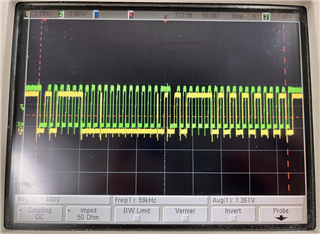

  • Hi, James
    First, can not use TI program(IPGUI.exe). because I use custom pcb board, do not use TI EVM.
    My test environment is
    TPSTPS6508641 communicate ZYNQ  XCZU2C6
    TPSTPS6508641 set default value.
    - F/W(using xilinx vitis) setting -> IIC Device ID : 0x5E, Register offset : 0x00 -> but IIC response is 0xAA (i can see data value using Oscilloscope and Vitis)

  • Hi Jinuk,
    Thank you for the additional information. I'm not sure why the 0x00 register would be different from the default configuration. Without a full register dump it's hard to tell if this is a larger issue or just a single instance of a register mismatch.
    How many ICs are showing 0x00 = 0xAA? Is this just one IC out of hundreds or are all the units you have showing the issue?
    James
