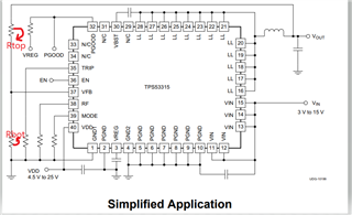

We are going to use the TPS53315 IC in our design.
So we request that you provide the reference schematics for this IC, as it will be helpful for us to design it further.

Hi Nivedha,
We don't have a reference design for this device, pls follow application section of datasheet to create custom designs and can also use webench for verification
Thank you
Savith
Hi Nivedha
TPS53315 has Vref=0.6V
Rbot/(Rtop+Rbot)=Vref/Vout
for 3.3 Vout and 0.6V vref you can use the above equation to get Rbot and Rtop
one such combination is Rtop=13.5kohm and Rbot=3kohm
