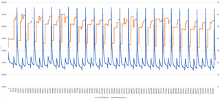

On my setup with the BQ40z80 and a 6s lipo in a relatively high discharge application (3C), I am seeing a variation in Full charge capacity at the end of discharge and the end of charge - by about 5%
After charging, the FCC is at its highest - ~250 wh,
On discharge when the pack hits cell term voltage, FCC goes to about 235 wh, during relax, it creeps around.
The more accurate FCC is the lower FCC calculated at cell term.  Is there any way to "lock" this in?
Thank you
The graph below shows FCC over about 25 charge relax, discharge relax  cycles.
