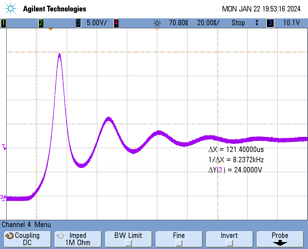

    I have attached a scope plot here of the primary power being connected - the measurement was taken at C11, the 22uF capacitor at the VIN1 pin of the MUX. VIN2 was already connected and stable when VIN1 was connected.
    I measured more or less an identical waveform at C126 when VIN2 is applied with VIN1 already connected and stable. As you can see the maximum voltage seen is ~29V.
    There are TVS Diodes on the inputs at the connector pins but there are Common Mode Chokes after the TVS and before the MUX input pins as can be seen in the schematic above.
    I removed the Common Mode Chokes L3 and L22 (adding 0 Ohm resistors at R17, R18, R54 and R56) to reduce the series inductance on the inputs and took the same measurements when connecting VIN1 and VIN2. Removing the CM Chokes appears to have a big effect on the measured transients when connecting the power adapters as can be seen in the plot below. The plot below is taken at C11 when connecting VIN1 with VIN2 already connected and stable.
    Even though removing the CM Chokes greatly reduces the ringing I still see the output dropping on some hot-plugs. From looking at the waveform you can see the VIN1 waveform reaches to ~15.5V initially. The OV detection is set to approx. 13.5V on the board I took these measurement on.
    Is the ~20us duration that the voltage is above the OV detection threshold long enough to trigger the OV circuit?
    My next steps are to disable the OV detection on this board (remove R19 and R50) and see if this eliminates the problem. I will also try to add 470uF caps to the MUX inputs if possible - this may be trickier as all components are surface mount and the layout is tight in that area.

  • Hi Paul,
    Definitely we'd want to avoid the 29V on the inputs, as the abs max ratings on the inputs is 24V. Also, the input drops to ~6V on the rebound of the ringing, and we'd want to avoid this as well as it is presumably after the device has already switched.
    20us is more than enough to trigger the OV circuit - I hope that this is the root cause case, but it looks unlikely to be so.
    Is the most recent test with the original PR1/CP2 resistor setup or the 44k/5k + 47k/5k setup? I would recommend continuing tests with the .../5k setup.
    Also, your previous test with 4.7uF caps on PR1/CP2/OVx makes me think that that acted as a sort of delay that coincidentally delayed switching until the input was stable.
    If you haven't taken the waveforms yet, is it possible to include the ST pin in these tests as well? It will tell us precisely when the device is switching over, and if it is switching multiple times.

  • Hi Patrick,
    I took some scope plots which included the ST waveform.
    These plots were taken with the 44.2k/5k + 47k/5k setup on PR1/CP2. R19 and R50 were removed to disable the OV detection on the input channels. The Common Mode Chokes were also removed (L3 and L22) to reduce the overshoot we see on applying power to approximately 15.5V max.
    The plot below shows power being applied at VIN1 with VIN2 already applied and stable. As soon as VIN1 is applied ST goes high and the output voltage drops as before. It looks like the MUX selects VIN1 when it is applied but restarts causing the VOUT drop.
    I then, per your suggestion, added 470uF caps to GND at VIN1 and VIN2. This seems to fix the issue. I did numerous connects/disconnects on both VIN1 and VIN2 without seeing an issue.
    The plot below is when VIN1 is applied (with VIN2 already connected and stable) with the 470uF caps connected across the inputs. As you can see there is no ringing on the input waveform. There is ~400mV dip in VOUT which doesn't cause any issue for the downstream DC/DC regulators.
    It appears to me that the TPS2121 has an issue with ringing on the inputs even with the Overvoltage Detection disabled. Adding the 470uF caps removes this ringing and seems to resolve the issue. Does this seem correct to you?
    My plan is to take measurements with the Common Mode Chokes back in the circuit (we would like them in for EMI reasons) and the 470uF caps present to see if that configuration is robust. I will post the results in a day or two when I have completed the testing.
    Thanks again for your help on this.
    Paul

    Great that adding the 470uF caps to the inputs resulted in cleaner switchovers. However, I do notice that in the last waveform you sent even after IN1 has risen, the ST pin shows that IN2 is active - so if the circuit works after adding the CMCs back, I would double-check to verify that the device is determining the source priority as intended after hot-plugging, and test when each input is removed as well to make sure there are no issues there.
    Patrick
  • Hi Patrick,
    I have spent some time in the lab testing the PCB with the 470uF caps added to the MUX inputs. I see no issue with this PCB, the MUX functions as expected with no board resets occurring on either connect or disconnect of either power input.
    So, it looks like the addition of the large caps on the TPS2121 inputs has resolved the issue for us.
    Thanks very much for all your help on this, it was greatly appreciated.
    Paul
