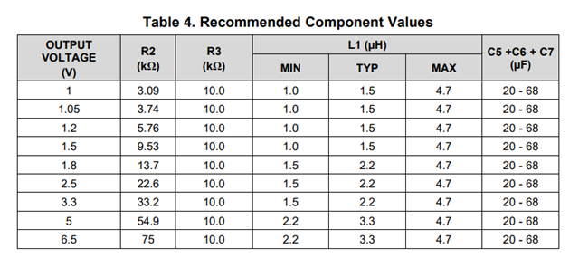

Hi team,
Could you let me know the theoretical basis of recommended output capacitance of TPS56209 (20uF-68uF) in the datasheet?
Is it coming from Eq. 11 and Eq. 15 in the app note slvaf11?
https://www.tij.co.jp/jp/lit/an/slvaf11/slvaf11.pdf
Also, is the  Example of LC Design Method for D-CAP3 Converter from p.7 directly applicable to TPS563209 (D-CAP2) design?
