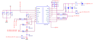

We are test DSAT function on 3 phase VSI using UCC21750.
Condition#1:
When upper switch pulse and lower switch short circuited.
Pulse off time for upper switch is around 1.338us and DSAT FLT report time around 300ns.
Upper switch VCE (C4 Green Color) [Inverter G3 PWM return tied with output V terminal]
DSAT FLT (Yellow Color)

I used 100pf as CBLK . and calculated tBLK time is around 1.8us. if we add “leading edge blank time” tDESATLEB around 200ns and tDESATOFF  (“DESAT propagation delay to OUT(L) 90% time”) ~300ns. then total time required around 2.3us.
But my upper switch low pulse within 1.338us.
Please guide us why we get two different times.

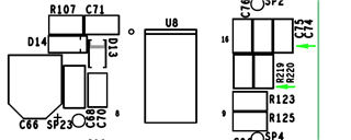

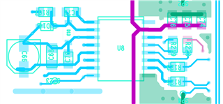

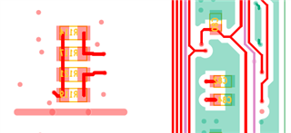

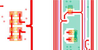

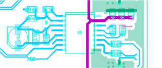

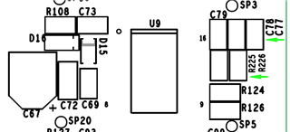

    Another thing we can take a look at is the layout. Layout can add additional parasitics to the circuit that can effect the timing. Could you share screenshots of your layout showing the HIGH side and LOW side DESAT circuit design?
    Andy Robles
  • Dear,
    Please find placement layout for U9
    and Placement for U8
    Thank you for the details. I will need a couple days to be able to take a thorough look at the layout. I will provide an update early next week. In the meantime please share any additional testing results you may find.
    Andy Robles
    Thank you for your patience and sharing the information. Looking at the layout I don't see a clear issue that would cause this problem.
    One thing I would like to circle back to is the fact that in one of the waveforms you shared the DESAT pin of the HIGH side driver is not actually reaching the 9V DESAT threshold that would trigger short circuit protection. I am wondering if during the short circuit event the test setup is creating radiated noise that is affecting the short circuit detection circuits. Is there a way you could rerun the high side short circuit test by shielding the gate driver from potential high current power stage components/traces in the system?

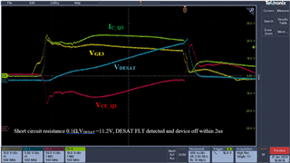

  • Dear Andy,
    Thank you for being so concerned
    We have taken a few more results. also, add two diodes connected to the switch collector pin. Precise 47pf cap is connected across Cblk. We are rectifying probing mistakes and taking these results.
    you clearly see DESAT rise above the threshold limit and Fault detected eventually pulses are off.
    Now if you find anything else in waveform please let me know.
    The waveforms look a lot better and clearly show the gate driver short circuit protection is being triggered. As mentioned before there are some slight differences between the performance of high side and low side driver due to board design(gate driver and power stage), and power stage transients. For this reason running this type of tests is important to understand exactly how the short circuit mechanism reacts with your specific system/design in order to fine tune to meet your requirements.
